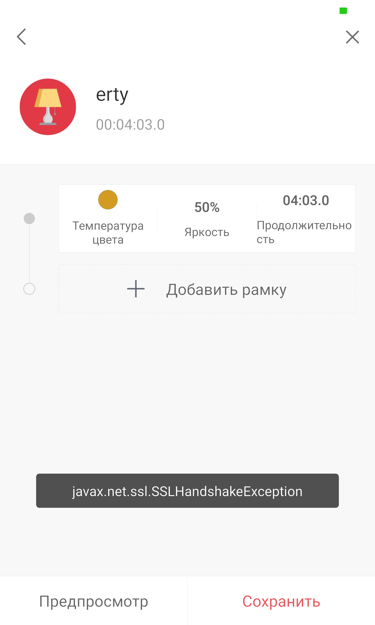

Updated to .70 version, Switched to mainland china server. The issue is still there
Which Android version do you have with your phone?
We have found the root cause. It will happen on Android version below lollipop, TSL protocol version issue.
Mine one is 5.1.1 lollipop
We have fixed the issue, could you have a try again? Let us know if it works.
It doesn’t work, Mainland china .70 version
I also have an android version 5.1.1. Updated to 70, there is a problem.
Yes same
.70 version. Problem still here.
@Olga.iso @Mahbub_asif @scherbakov.al
Sorry for the inconvenience, a new version v71 with the fix is available from beta test, please have a try.
