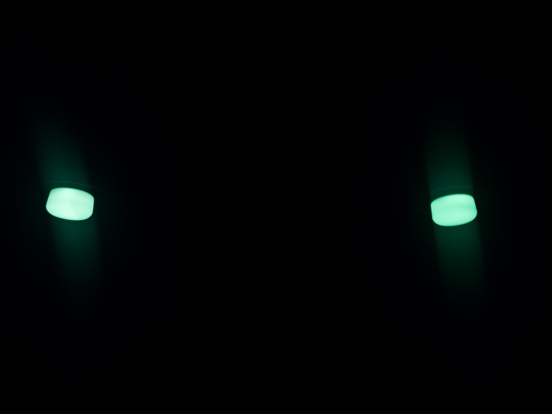

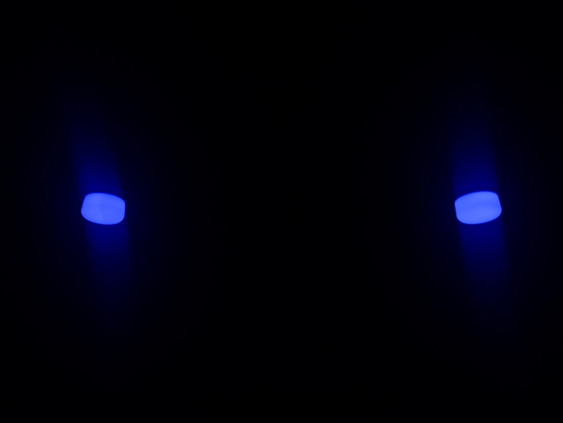

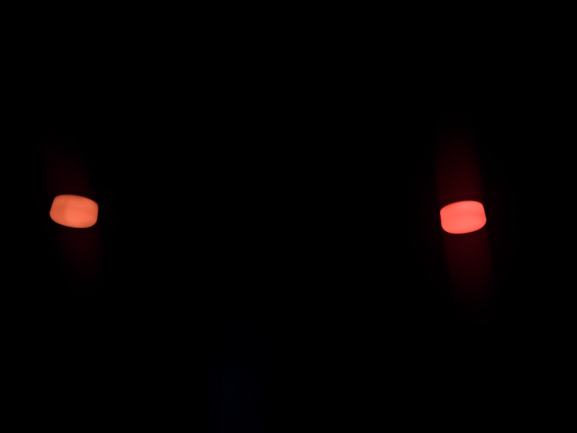

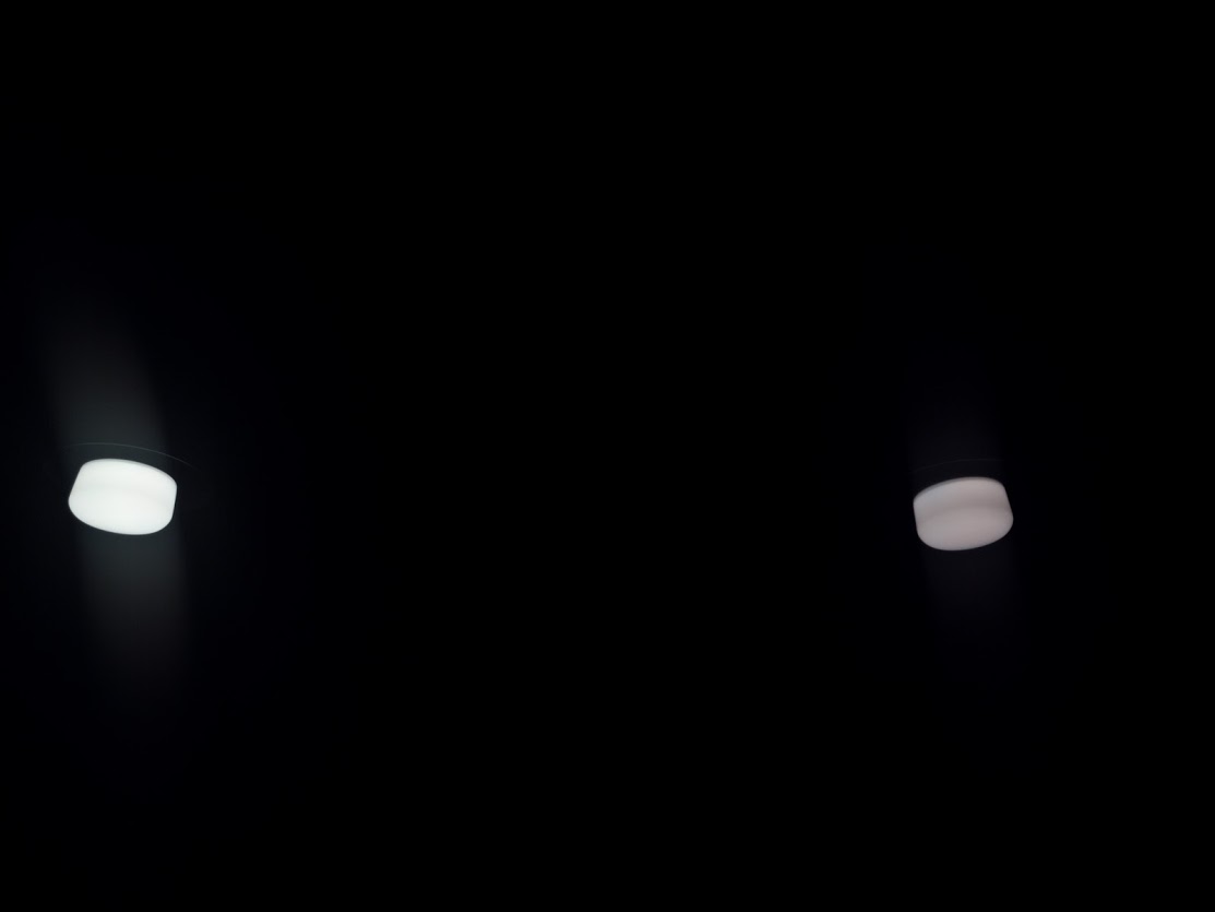

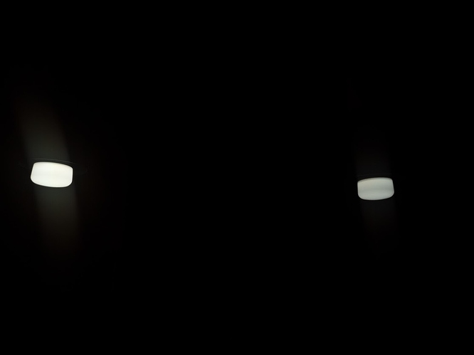

For what it’s worth, I have bought a couple of S1 bulbs and tested if any improvements were made concerning the 1% brightness.
Upgrading the S1 bulb to 2.0.6_0027 gave the following results:
left = V2, right = S1
white
warm
cold
color - doesn’t seem to be that much of a difference
2 个赞
