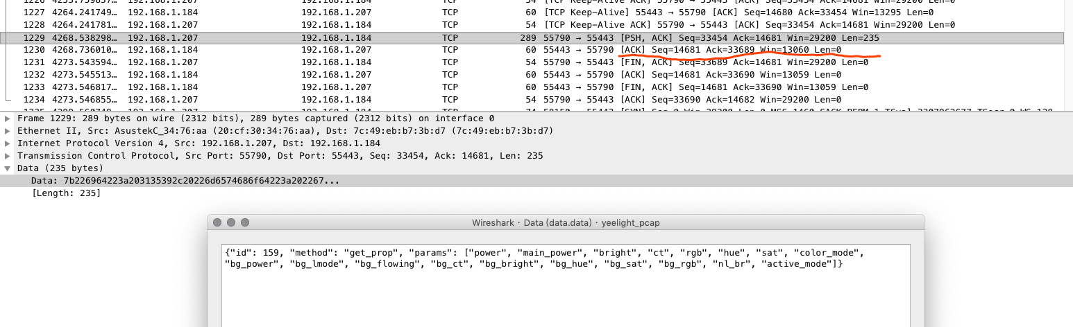

I have a pcap showing the strange behavior of the bulb.
https://drive.google.com/open?id=1dP0NeGRgt3hogTTpzjs2ocSyMr6LPXtW
192.168.1.204 is the client
192.168.1.184 is the bulb
The bulb was restarted at around 60 seconds into the pcap.
The bulb seems to behaving correctly until 4232s, which is the last time a request gets a response.
The bulb does not respond to the next request at 4268s, (and 4299s, 4330s, 4361s, …).
This pcap was done on fw 2.0.6_0051, because I am having the same issue as TheZoker

Thanks for your pcap, it provides very useful information for debugging.
BTW, did the bulb have internet connection when it stopped responding to the request?
From your HA log, seems the bulb initiate the close action, which is different from what @qcrist 's pcap shows. Could anyone familiar with HA confirms that this log DOES mean the connection is closed by bulb instead of HA?
Yes, I had an active internet connection throughout the entire test.
The “Bulb closed the connection.” message is given in the yeelight library (which is used by HA) whenever an error occurs on the socket. This INCLUDES timeouts.
This should be the same problem as the one shown in my pcap, which is the bulb not sending the expected response message.

The error does appear to be a timeout
The bulb’s TCP stack actually received the “get_prop” command and acknowledged it, but somehow, the “get_prop” response is not sent out. So the problem is either:
a. Application layer didn’t receive the message from TCP stack.
b. Application layer has some issue handling this message.
Since you can still “toggle” the bulb under this “mode”, it’s highly possible that case B is the root cause. We will check our code and see what’s the problem. Thanks for your help!

I have the new firmware installed. The behavior seems to be the same as in the previous pcap. The message is ACK’d, but there is no response.
