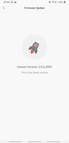

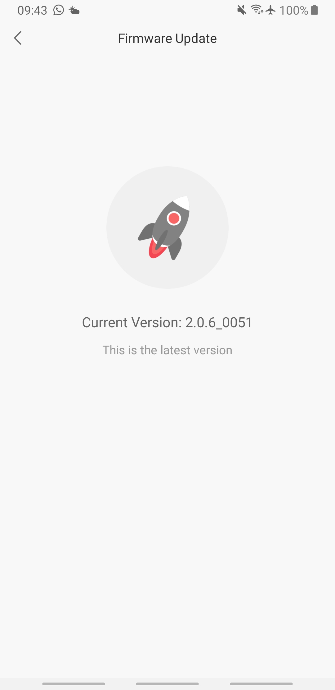

There still no update available for me
current version 2.0.6_0051
