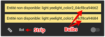

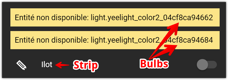

So, when I reboot my home assistant I just can see my strip yeelight but not my bulbs:

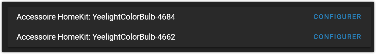

But I have this notification:
It’s surprising because I do not have HomKit
My bulbs Yeelight are in 2.0.6_0065 : not working
My strip Yeelight are in 1.4.2_0050 : works well
You are talking about discovery, as we have mentioned in previous comments, you need to raise this issue to HA team since they didn’t implement the discovery of Yeelight device following our Spec.
