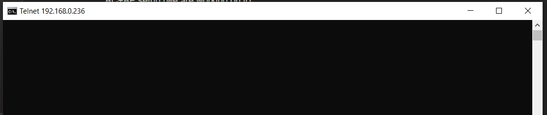

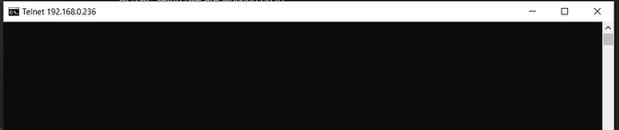

I’m now able to connect but no response. Cursor just blinks and CLI does not accept input when typing anything.
Edit: Or maybe it isn’t able to establish a connection?
Yeah, it requires very specific input. If it doesn’t understand it’s unlikely to respond at all. Copy and paste this into your telnet session and the light should toggle (turn on or off depending on if its on already) and you should see a response.

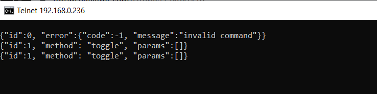

The command works but does not receive a response. I believe this behavior has been mentioned before by another user.
Looks like an invalid command receives an error. But a valid / successful command gets no response.
Yep, that’s exactly the error I had seen. Double check that you are on firmware version 2.0.6_0062 just to be sure.
