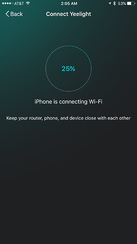

The YEELIGHT Light Strip will not finish the setup process. Remains stuck on 25%. Steps taken include: multiple resets, switching servers (China and Singapore) and more. Router finds the light strip and remain on 25%. This needs to be resolved soon or I will have to return the product.
1、You can try MiHome app or Android Yeelight/MiHome app.
2、You firstly check wether the device is in the router dhcp list.
3、Second, check the router firewall setting.
4、Third, check wether your phone or router is connecting to network.
5、Try using phone as a wireless ap(access point) to reconnect your light.
