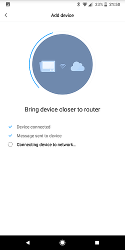

The bulb and gateway don’t make the connection to the server. Message is take device closer to router. Than the time-out message comes. Try again. Did this more than 20 times and resets. No success.

This is what happens every time.
