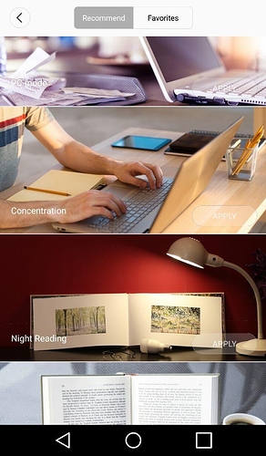

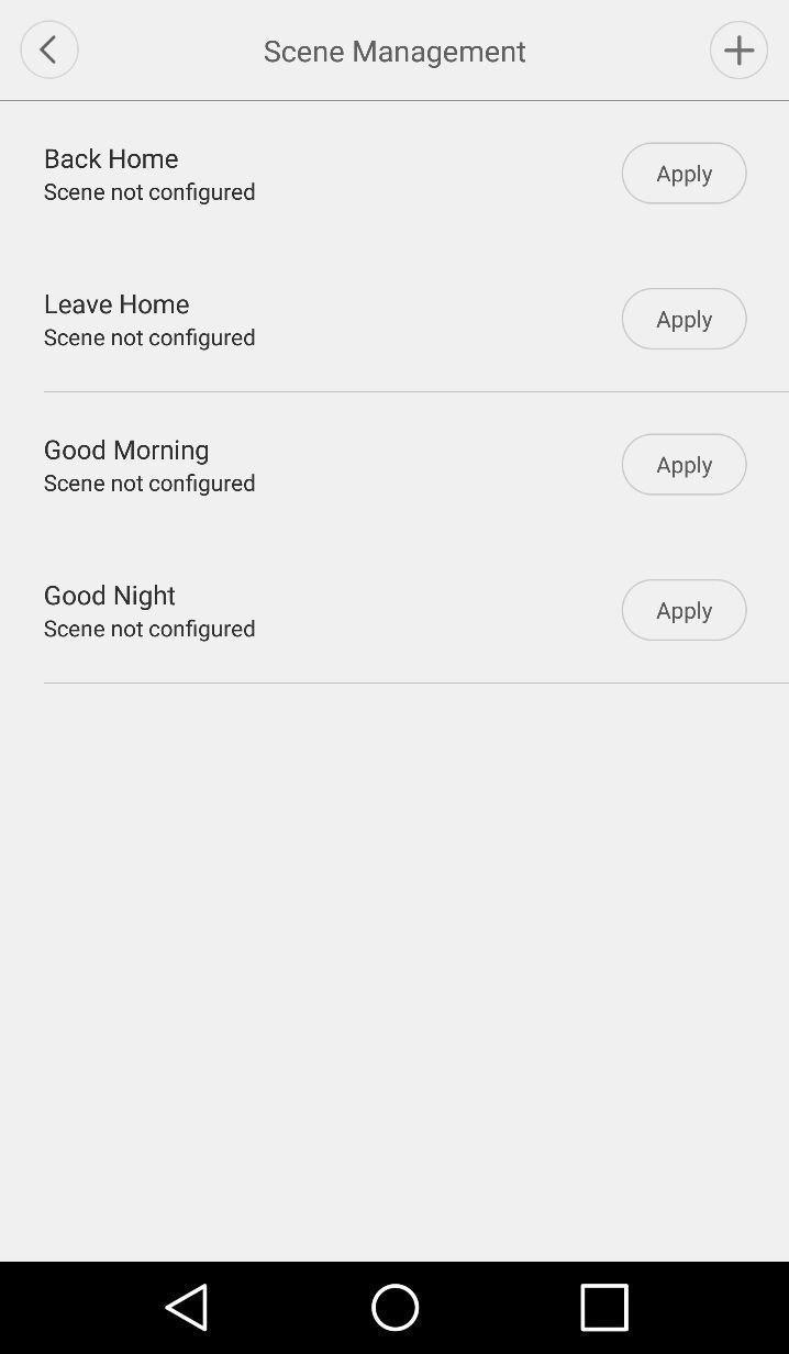

I just installed the ceiling light and installed the app connecting to Singapore server. However i can’t find the sunrise button. Would you mind telling me where can i find it?
I understand that you have added the Sunrise/Sunset scene in the latest version for ceiling light.
I am using yeelight app 2.3.13. However, I don’t see the Sunrise/Sunset
scene, attached with two pages that i think you are referring to
