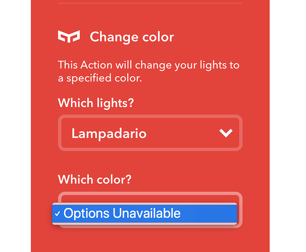

Hi, I’m trying to set this applet on IFTTT but I have an issue.
On the last select (Which color?) I can’t select anything because there is only “Options unavailable”.
How can I solve this?

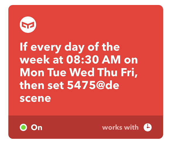

I’ve “solved” creating a scene with sunrise and creating a custom applet.
ok
You can operate what angelocala had did.
Scene does not provide a solution for me. Scenes are predefined. I want to set an IFTTT action that takes a number and sets the color temp to that number.

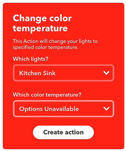

When I choose “Change Color Temp” I see the same as angelocala94. “Which lights?” loads and I can select a light. “Which color temperature?” shows “Options unavailable”. The same thing happens when I choose “Choose a brightness”. “Which lights?” works but “which brightness?” does not.

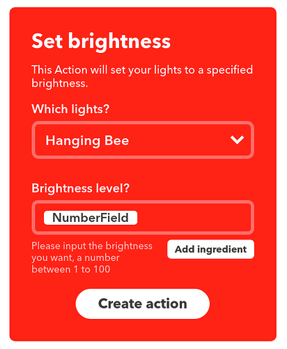

I would like to set color temperature the way I can with “Set Brightness”:
Did you pick “color temperature” as favorites by Yeelight APP?The “Which color temperature” options will load your “color temperature” favorites which you picked on Yeelight APP.

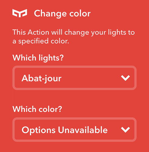

I can fill the applet up to the last field, which is COLOR and it has no options available, no matter what I do.
most Yeelight IFTTT applets are plagued by this issue, only very simple stuff remains usable @sheldon
