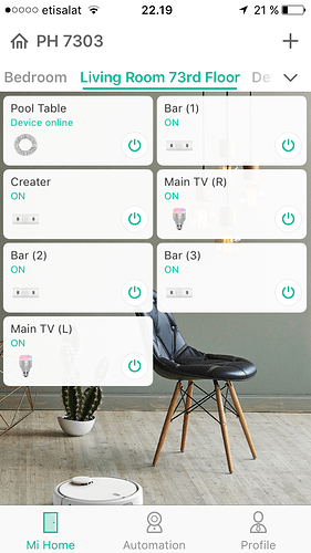

But problem is, I’m missing 13 of my lights from the YEELIGHT app in the MI HOME app
What do I do? We agree that MI HOME should automatically update devices added in the YEELIGHT app right?
I’m running the latest IOS APPS
Singapore server for both
MI ID 1854262590
Strange thing is that under HOME MANAGER it says 21 devices in total
but everywhere else they are not listed anywhere
bedroom has 1 device
living room 7 devices
No devices anywhere else to be seen

As you can see I have 22 devices registered in yeelight app right now (including 2 candelas) but MI HOME is only registering 7 lights + 1 camera (but in one of the screenshots it says 21 devices, but they aren’t visible) ; (
