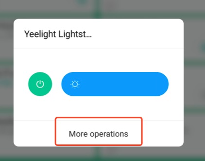

Click card of lightstrip, it will be load a view to control. So is there any response when you click the card?

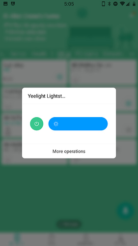

Not sure why, but I do not have this “card” option at all. Just deleted the lightship, reset and added again. Still no control - I can only turn ON or OFF and adjust brightness. Clicking more operations does nothing.
It seems you have enabled “Shortcut card”, Please click “More operations” to see what happens.
Yeah, does not do anything at all. I have “Current version 5.4.50” it was side loaded from Xiaomi itself, going to try deleting it and getting the Google Play version, maybe it’s better. Guess I will go grab some Yeelight e27 bulbs and see if there is a menu with those.
