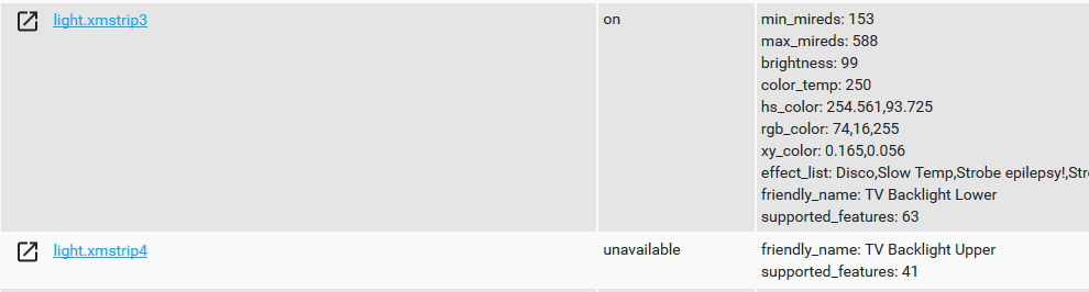

Here is my Homeassistant view of the two light strips mounted behind my TV:
As you can see, the upper strip is unavailable and the lower strip is available and on. Both of these are plugged into the same power outlet. I try pinging the available strip:

The status in Homeassistant shows:
xmstrip4 was in the exact same state as xmstrip3 before it became unavailable. All of the values would be identical as they are using the same scene.
