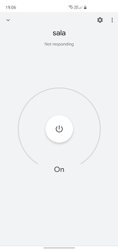

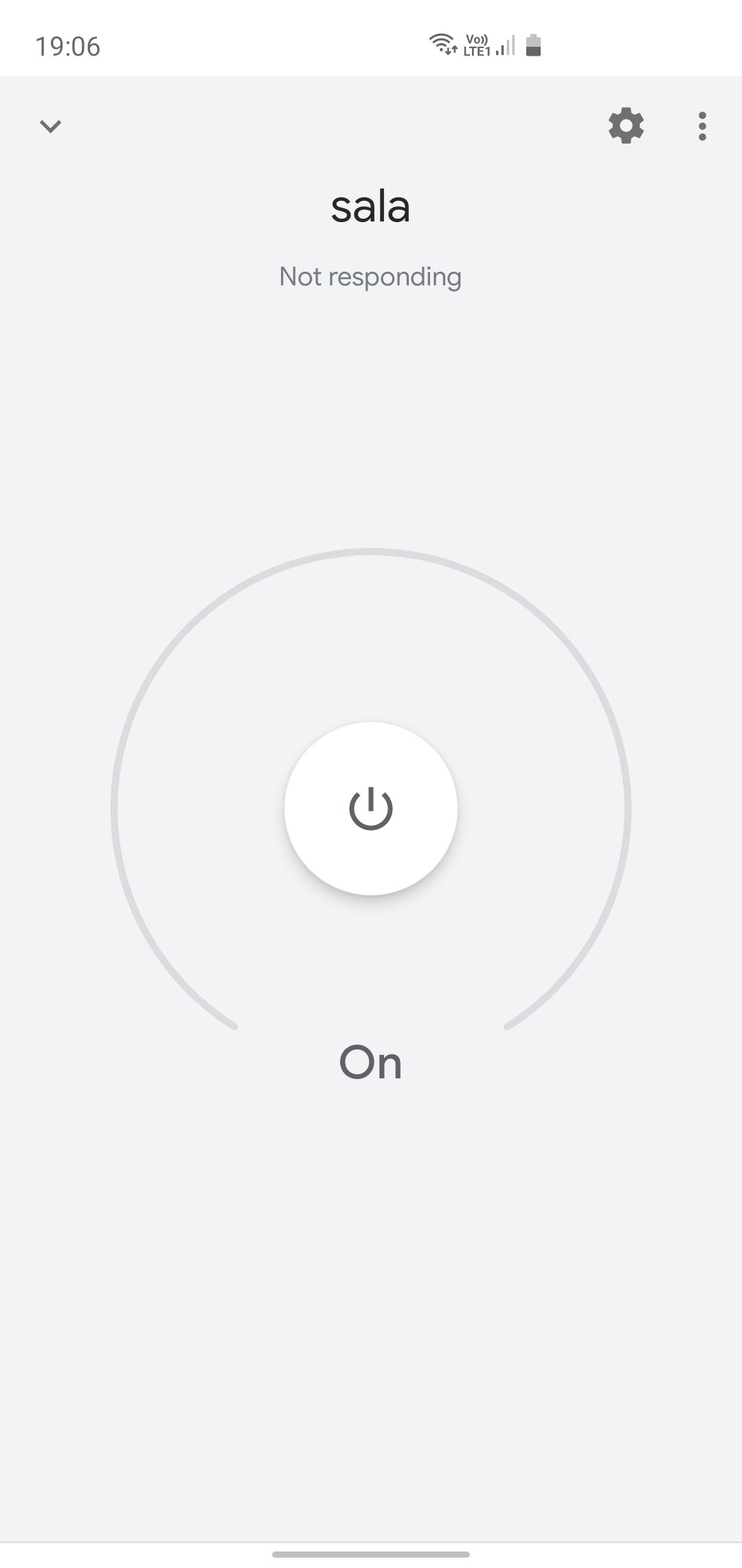

Hi, I’m having a similar problem.
All my bulbs and lamps stopped working on Google Home app.
they can be turned on or off, but i can’t control anything else.
@tiagomb voice command works?
yes
now they’re offline even on yeelight app. i have zero control over my bulbs and lamps.
