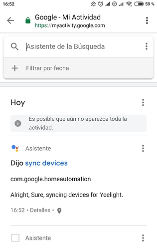

Hi,
I tried it, the Google Home said me that:
“Alright, Sure, syncing devices for Yeelight.”
But I still having the same problem :frowning:
