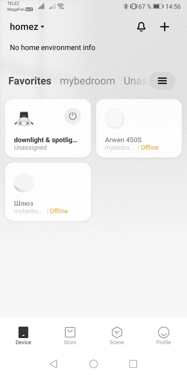

Buy Yeelight Downlight M2 Pro (YLTS03YL, initial software version - 1.4.4_0009) and yeelight mesh gateway (YLWG01YL, software version - 3.1.0_0027). After connect lamp into yeelight app on anroid, in devices list he disabled and not active. I cant monupulate with lamp. Then i install mi home app and lamp been active in device list, but not react on any command, cant on/off, change brightness, or any other command. In devise settings i try update software, and successfully update to 1.4.4_0010, but nothing change .I thought it was a problem with the gateway becose he wasn’t show in mi home app device list and i bought xiaomi gateway 3 (ZNDMWG02LM) but nothing change, however Yeelight Downlight M2 Pro exists in bluetooth child devices with this gatewey, with yeelight mesh gateway not, and i cant find Yeelight Downlight M2 Pro in mi home app only in yeelight app. I dont know what the problem, mb someone knows and resolve this problem. Thx!

sometimes he is active or not, but when he active, he not react on commad and have wrong on/off status. this i try with yeelight gateway
Now i try repeat with Mi gateway and one of them work, and react on command, WOW. Before he not work. Interesting)
