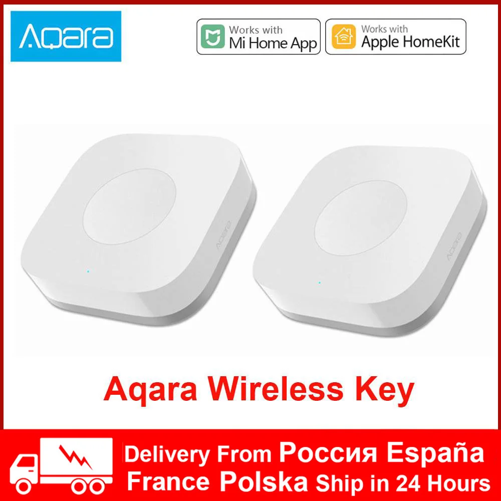

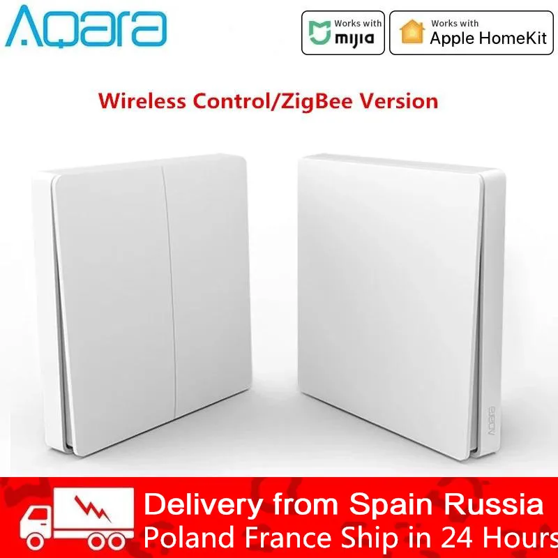

You can use any Aqara or Mijia wireless switch:

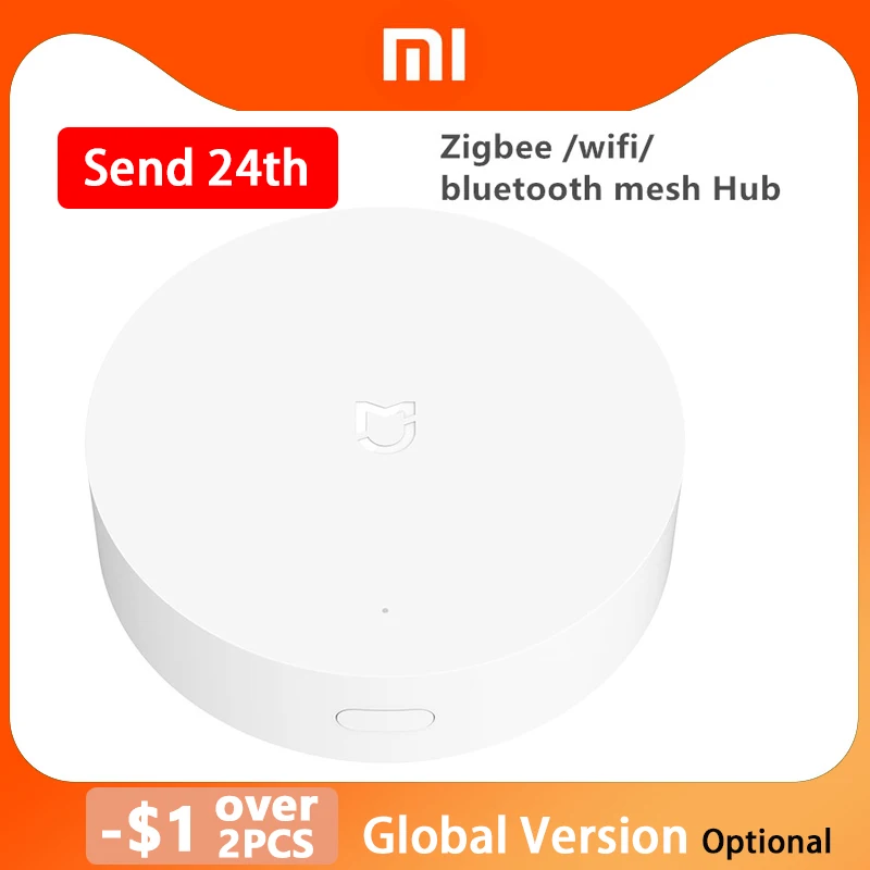

but you also need Zigbee gateway:

I bought both of them
But xiaomi smart hub won’t connect to Smart Life
It connects to Xiaomi Home only
And my GU10 can only be added to Smart Life
How can I do?
Thanks
Smart life? This is Yeelight forum. Yeelight bulbs connect to Yeelight app or MiHome app. Smartlife is Tuya. Completely different eco-system…
I tried because it doesn’t work with Xiaomi Home neither
I made a reset on Yeelight GU10 (they started flashing) but Xiaomi Home can’t find them…
Is there a server to select or sth? I bought the Xiaomi Hub just for that but Xiaomi Home can’t find the GU10…
