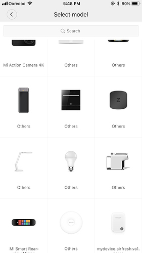

However, for some reason, after i tried changing the language, it didn’t work anymore. (Same thing for a wall switch). Also when I want to add new items, the list has shortened and the switch are non longer in the list.
Any thoughts on how to get the gateway and switch back ?
Do I have to do it all over again ?
You don’t need to connect the gateway again. You just need to do the trick to login to mainland China server and change to Singapore as fast as you can
