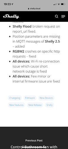

Hi all, I was having these problems too with bulbs (going totally offline/unavailable) and strips (unavailable and flickering) but at my place, it was caused by a problem coming from my Shelly devices (I have one Shelly1 and six shelly2.5). Those were running on firmwareversion 1.8.0 and since 2 days those are now running on 1.9.3 and guess what: no single drops anymore on my Yeelight lights, not in Home Assistant and not in the yeelight app.
This was mentioned in the changelog (4th bulletpoint):
I hope this is of help to someone of you too!
