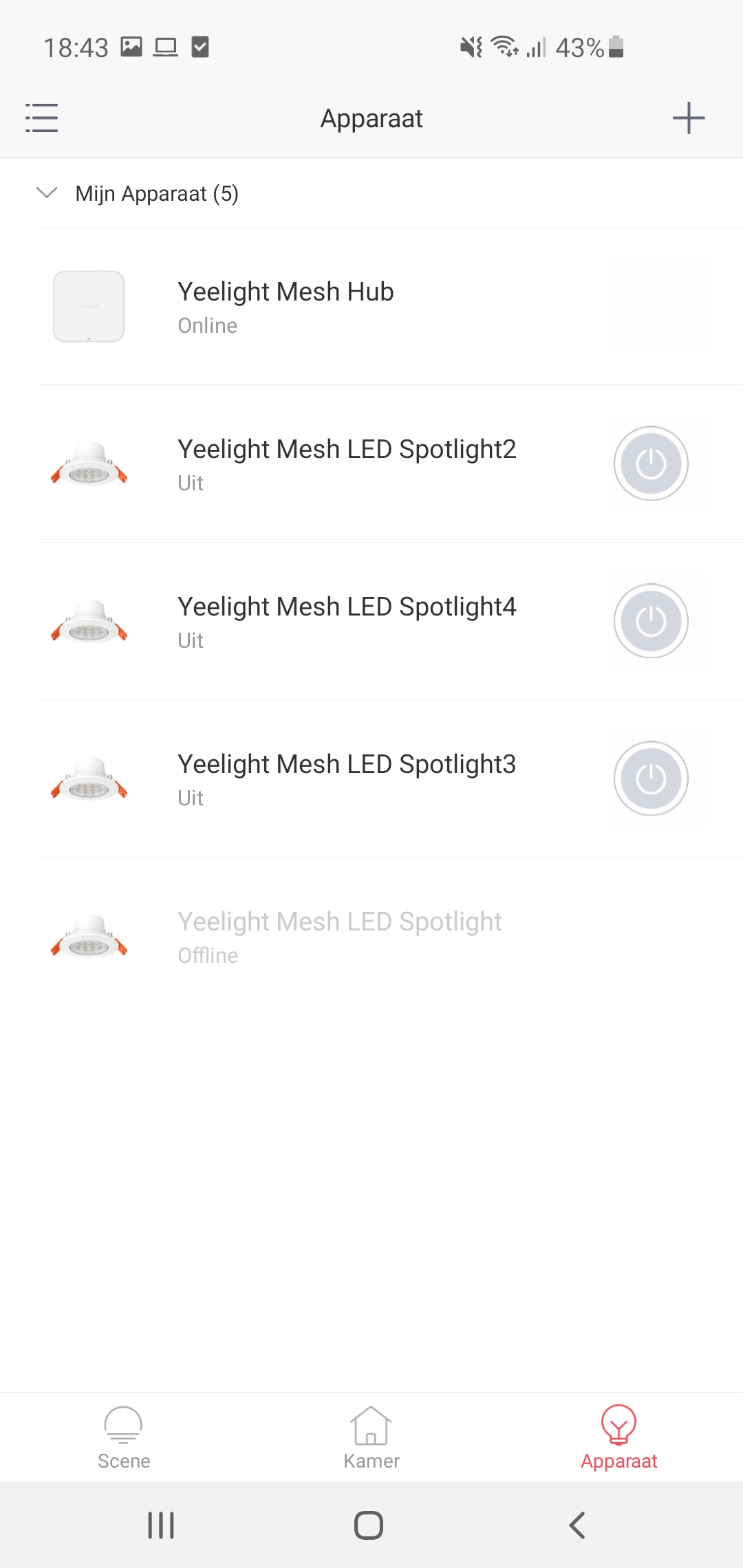

In this app I cannot find the spotlights and also the gateway. See print screens.
In the Mi Home app you have to use Mainland China sever
Also for Yeelight app you should use China server in order to make them work

I switched to China Mainland in the Home mii app.
From that moment on, he recognized the spotlights and I could operate it directly with a telephone.
