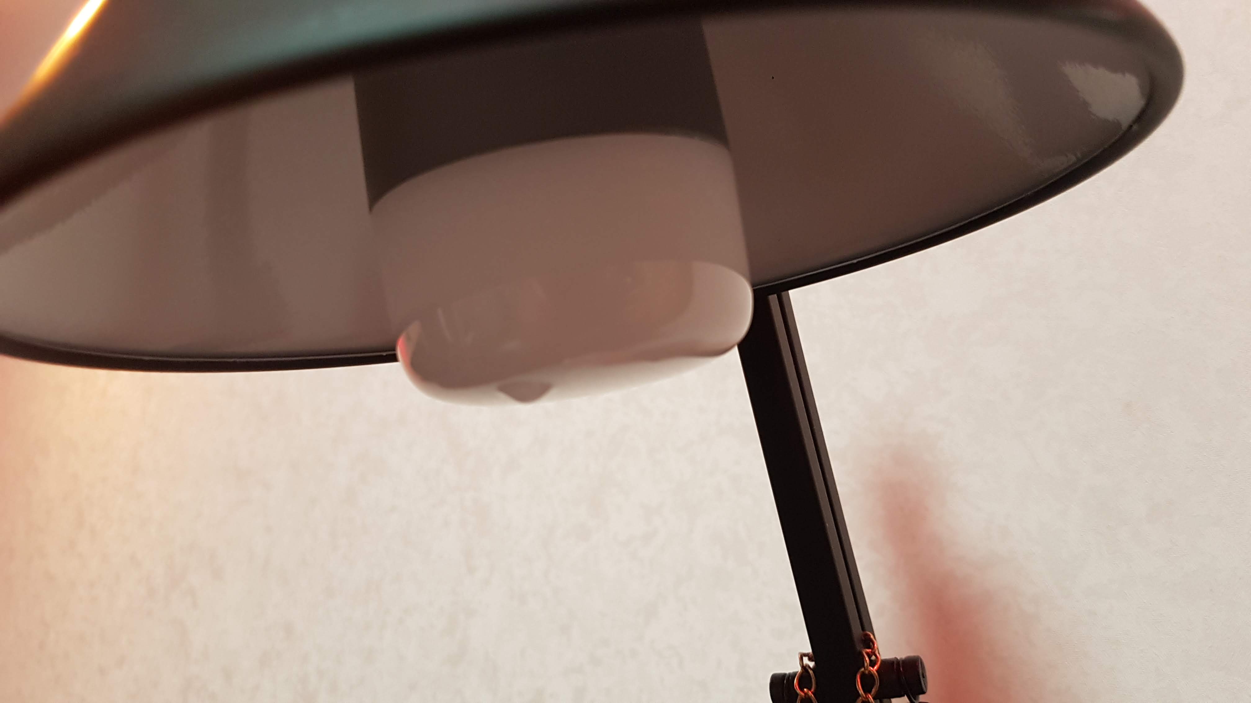

So model of bulb I have is YLDP02YL. I have 6 of them. I’ve been using them for 2.5 years and recently noticed a drop of liquid on the white plastic part of a bulb.
This liquid is oily when you touch it.
I’d like to know what’s the reason for this? Is this liquid safe? What should I do? Currently this liquid have been found on 3 out of total six bulbs.
Drop appeared again on the same bulb. This time I did photos.

Finally after 3.5 years I found the cause. I would have discovered it three and a half years ago if I had taken the bulb apart then. But I did it now, since all 5 bulbs are still leaking.
So. Where the cap meets the body of the bulb there is a white sealant. That’s the cause. It’s decomposing probably because of heat and producing the oily liquid.
Here it is:
