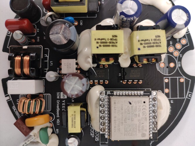

Hi, I have a similar experience. I’m sending a photo board where the burned parts can be seen. Can anyone post a photo of the driver board with the values of the damaged resistors R22, R25 and Q1. Thank you
The same problem. I’ve changed all the components, but it seems, that I have burned BP2877. And I can’t find it anywhere. Don’t know how to change it. Is any alternates?
