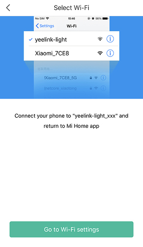

Got a new yeelight color bulb.
Downloaded both mi home and yeelight apps.
Tried many many time to add device with both apps.
When either app told me to connect “yeelink-light” on my WiFi list, there’s no “yeelink-light” on the list!
I’m so fed up. Anyone could help?

Hi, I’m having the same issue
I’m using an iPhone
First, the Yeelight app asks me to reboot the light bulb, than asks my wifi password, the problem arrives when it asks me to select the bulb’s wifi “yeelink-light…”. I have to select it at my iPhone’s configuration screen, then, when i come back to the Yeelight app, the iPhone doesn’t recognize the bulb’s wifi anylonger and the configuration stops at 25%.
Maybe it’s different on iPhone, I never had to select any bulb’s wifi…
Hi pedrooo, thanks for replying, my issue is somewhat different, you have found “yeelink-light xxx” on your WiFi list to connect but stuck at the connection process; I never have that “yeelink-light xxx” on my WiFi list…
However, I managed to have the bulb connected to the yeelight app finally but still couldn’t add it to the mi home app.
We all know the bulb only works on 2.4GHz WiFi but not 5GHz. Choosing a 2.4GHz network on iPhone to connect is not enough. I had to log into my router’s setup and turn off 5GHz. After logging back in the yeelight app, my bulb somehow “magically” appeared, asking if I wish to connect. So without the “yeelink-light xxx” ever found on WiFi list on the iPhone, I finally have it connected after few hours of hassle.
