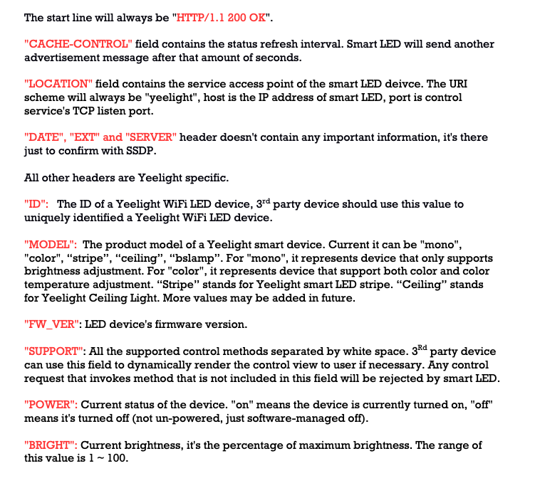

The SSDP-like protocol is actually very easy and simple. It does contain enough information to help identify the device. For example, the response to discover request contains device ID which is unique across all our devices, it also contains all the method this device supports, it also contains the ip and port the bulb is listening on. Please check the interworking spec for more details.
Ah, makes sense, so that won’t work in this case, so the SSDP-like is the one we should be using.
Yes, I’m familiar with the discovery protocol, and it itself is supported by the upstream library. There is one problem though: the ID is not available via the API (i.e. without discovery), so this would close the ability to use statically configured IP addresses inside homeassistant, which is useful for those having their devices in different networks than where the discovery process is running. Also, some HA users also prefer to simply use static IP addresses to avoid any sort of discovery processes for various reasons, so removing that functionality is a no-go for us.
That being said, I just did some testing and from the looks of it the discovery stack on my devices will also answer to unicast discovery calls (as mandated by the SSDP spec, but not stated explicitly in the yeelight spec), which seems to be a promising way to make this work (i.e., we could send a discovery on all statically configured bulbs). Could you confirm if we can expect this to work on the whole range of yeelight products? Because if yes, my next steps will be to start making the necessary changes across the stack to make it happen :slight_smile:

Ah, I see your point. I can confirm that unicast address can also take the discover request and send response.
