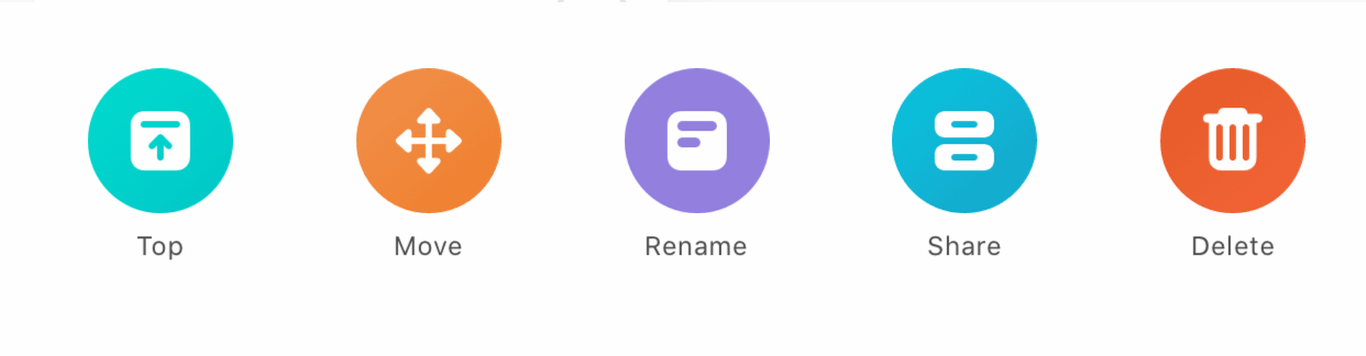

The option is no longer available… no HomeKit button after long press
I had the same issue until i tried something. slide to the left on the icons, there are more hidden. It’s just a bad interface that makes us believe that’s all the icons when in fact they are just hidden.
