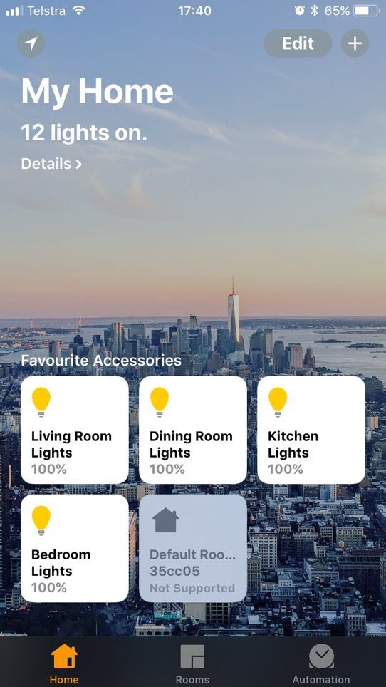

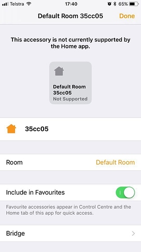

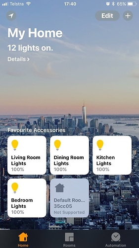

Im having an issue with one of my Yeelights in the Home app. I am able to connect, setup and control the light in the Mi and Yeelight apps on my iPhone but when i open the Home app it says the light is “Not Supported”. If i check the log when i enter homebridge it does say it connects/true.
The weird issue is if i disconnect/unpair that globe and repair it from a “factory reset” the Home app will see it and control it but then it will go back to the “Not Supported” state after a brief time.
Has anybody else had this issue? I am able to connect and control my other 12 Yeelights in my house via the Home app without any issues, it’s just this one globe and because it works with the Mi and Yeelight apps I know its not an issue with the globe.

This morning I removed homebridge from the Home App and re-added it again. I was able to control all the lights but I couldn’t change the name of move it into another room and it was saying The Accessory is Blocked. As i was able to control the light i would just put up with that but then when i followed the details to run homebridge on start up (following the steps on this link https://github.com/nfarina/homebridge/wiki/Install-Homebridge-on-macOS) it then said the accessory was not supported (like in the photos and not being able to be controlled) and it is still saying The Accessory is Blocked. I have tried stopping the plist. but that doesn’t fix the issue.
Is there a way to unblock the accessory? The Yeelights are up to date (version 1.4.1_52) and I’m running the ios 11 public beta. I have been able to add other Yeelights with this one still playing up so I’m not sure why it is this one globe. The globe has the same information as the others so I believe the globes are the same model. I have tried deleting all the cached files as well
