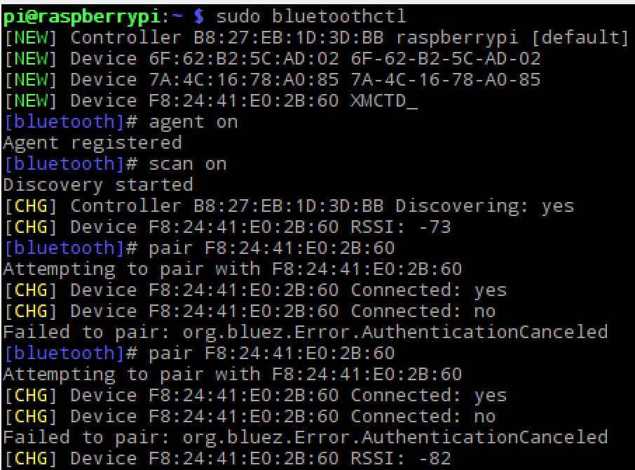

I’m trying to connect my raspberry pi 3 model b with the bedside lamp but it won’t. I get the message org.bluez.Error.AuthenticationCanceled
Maybe I’m doing something wrong to get the lamp in pairing mode. Any suggestions?
Could you post more log messages here?
This is how my terminal looks:
Where do I find bluetooth logs?
Why do you connect the lamp through this way? Could you just install homebrige-yeelight and try?
Because the homebridge-yeelight couldn’t find the device. But it works now after rebooting and connecting via bluetoothctl
