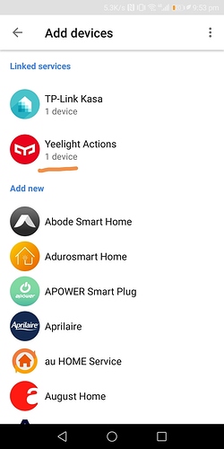

Have you setup Yeelight actions within Google Home app?
Could you show me your xiaomi id?
xiaomi ID: 1632525023
Please @yusure help to check.
@deishelon
Hello,
I found you have one color bulb, this screenshot is normal. Do you have any other bulbs?

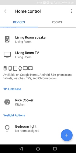

no, the problem is that I can’t control this bulb from Google Home, it says “Sorry I can’t help with that yet”
What did you say command? when you say “What time is it”, it works?
Everything works (I’ve got a smart plug), but light nope.
I’ve tried to say:
“Turn on everything” - the result was turned on only my smart plug.
“Turn on lights” the result was “Looks like those lines have not been set up yet…” - However you saw the screenshot that light I’ve set up everything, and Google home app see the light.
“Turn on the bedroom light” - the result was “sorry I can’t help with that yet”
