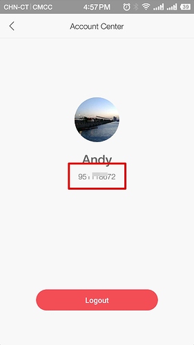

In the page of “Account Center”, click ten times in a row of mi account, you will enable “developer mode”. If the lamp using LAN, you will see device name with suffix “(LOCAL)”.

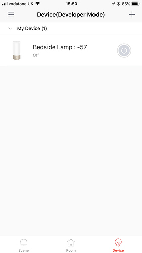

Should I see the local suffix in the following screenshot, or is it somewhere else?
That’s right, the suffix of -57 is RSSI (Received Signal Strength Indication) of the lamp from your router.

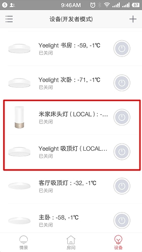

The screenshot below is mine, you can see that device I make in red rectangle is in LAN Control. As you can see, there is also another suffix of “-1 ℃”, this means temperature of the chip. Not all of the devices support it, -1 means no result back.These information just for debugging. It seems your application is not up to date, the latest version is 3.1.11.

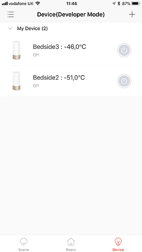

Ahh yes, it seems the iOS app just updated last night to 3.1.08, and developer mode shows the temp value now.

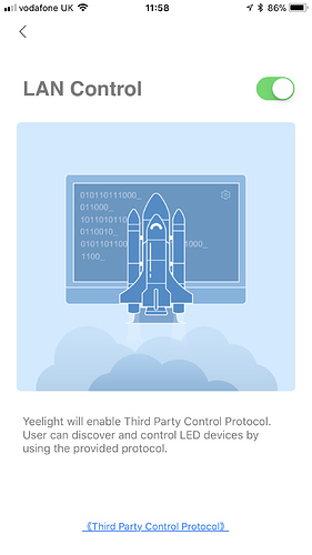

Can I check I’m looking at the right place to enable LAN control because both my devices don’t show LOCAL as per your screenshot (mine below):
To check Local Mode I go to a device, press the “eject” button bottom right (triangle with line underneath), press the LAN Control button (with lightening bolt icon), and I see LAN control is enabled. Is this right? If so, what can I do to troubleshoot why they aren’t showing the LOCAL suffix?

Yes, you are right to enable Local mode.
You can have a try with Android phone, IOS doesn’t show LOCAL suffix, we will add it in next version.
ahh ok that makes sense, thanks. Do the numbers -46 and -51 indicate a local connection? No worries if not as happy to wait for the next version.
Thanks.
It is the value of RSSI (Received Signal Strength Indication), usually if it is smaller than -70, it means the signal is weak, seems yours are ok. And you can google it by the way.
That’s signal strength in db.
