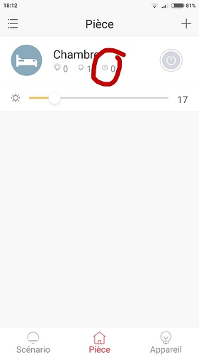

Just found this thread. I, too, just bought a Yeelight color bulb on Gearbest, received it this week. I had no problem setting it up, had no problem testing the different colors, but it keeps going offline. I put a widget on my phone which allows me to start or stop the light, but it only works in white. When I go on the Yeelight app, it says that the bulb is offline, I can’t access it, can’t change the color. If I had bought a white bulb that will be fine but considering I put the extra dollars to have the colors it is starting to really be annoying.
I tried with a config in Singapore and China, the problem happens with both scenario. The only thing working is to reinitialize the bulb, then it works fine but for a few hours only. When it is offline, I have a “1” next to the “?” which I guess means offline.

Hello,
So while offline (according to the app on my phone) :
I tried using the bulb with voice command and it works perfectly fine (with Google Assistant). I can turn the light on and off, modify the color and the intensity.
If I use the app i can only turn the light on and off, I can’t choose the color or manage the luminosity.
The Google Home device is a Christmas gift so I can’t test it right now. But I guess if it works with google assistant on my phone, I believe it will work fine with Google Home mini. If not I will come back to you next week.
The issue seems to be coming from the app and not the light itself which is a relief.
